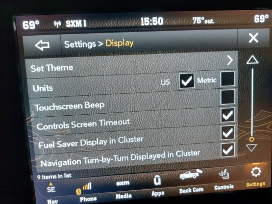

On my '21 Warlock, the ECO lamp display option for the EVIC is in the Uconnect 8.4C radio.
Fuel Saver display.
BTW, the ECO lamp and function is not directly related to the MDS. There are many threads here at Ram Forum, explaining and debating the relationship between those 2 systems. :cool:

Unfortunately the " Eco light" was shut off in the touch screen. It comes on now.
Ignore dat idiot light. Drive yer truck, maintain with quality stuff and enjoy yer ride.
