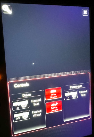

U5 has many bugs, as well as U4.
There is bulletin for rear camera on U5. Same issue on U4 but no update for fix. I posted before sometimes nothing on screen will work. I can't turn off heated seat/steer wheel.
Pic of back up Camera.... does this once or twice a month. the little dot is from my phone, not camera. Turn off the truck, move far enough away with key, wait 5 mins., It works again.
