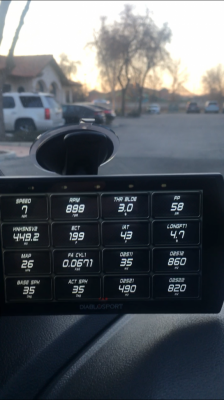

Can’t upload a video so here are two different pictures. O2 gauges are located in the bottom right corner. Engine temperature is 199 truck had been running for a good 25 minutes before these pictures were taken

According to your 2 pictures both the pre cat o2 sensors are switching normally and the post cat are remaining fairly stable, so based on those 2 pictures there’s nothing really wrong.
It’s really best to graph them over awhile though and monitor for any irregularities.
