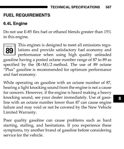

48068260-0F73-48A2-8919-2BF59B1D9E05.jpeg2019 gasser manual - do with it what you will
johnwayne
Jan 8, 2021
12
12
calgary
2015 slt
Well if it says 89 octane run 89. I cant imagine 87 doing any harm. HOWEVER being under warranty .... I have seen them void warranty for less. Due what it says. No brainer to me
