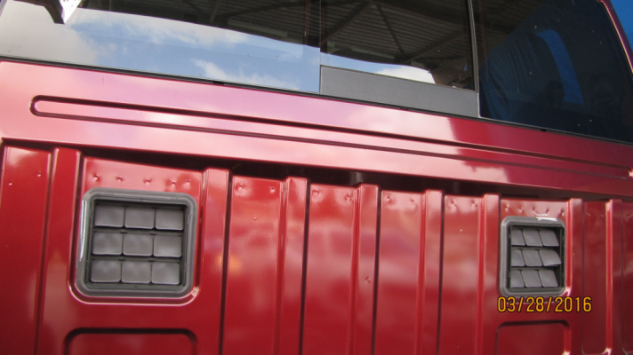

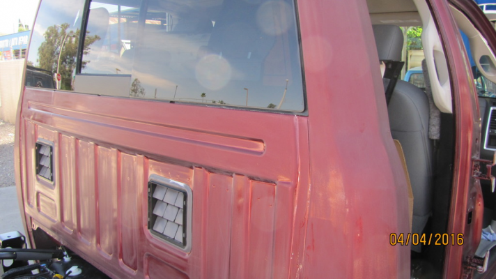

There is a big exhaust vent behind the rear seats maybe it is stuck closed.

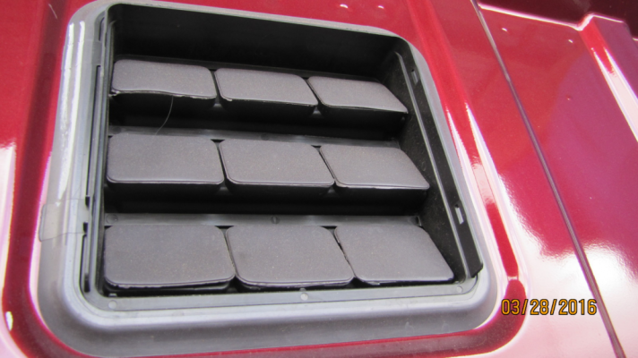

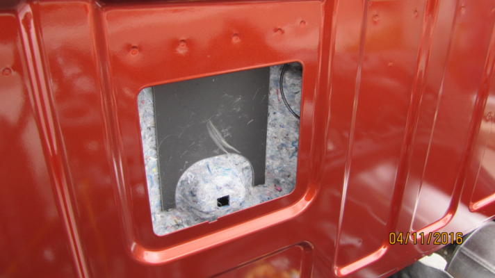

These are air pressure vents, without them, you would have to roll down a window a bit to close a door
Instead having to slam your door shut

That's the kind of info I'm looking for. I looked around under the back seat but I didn't see anything. I will dig around deeper.
Do you know if it can be seen from under the seat bottom or is it higher up behind the seat back cushion?
