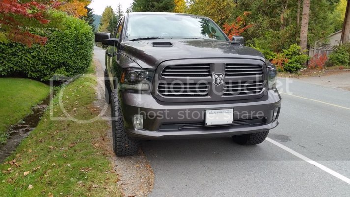

Never wound up taking a photo of the completed assembly with the wheel off, here is how she sits on stock wheels with the 5100s at 2.8". (1/4" nose high with the back empty, I have plans to lift the rear soon).

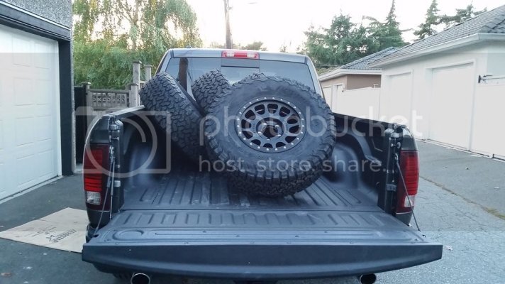

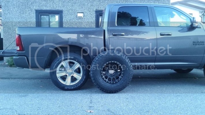

Picked up the wheels! 35x12.5x17 BFG AT KO2s on Method NVs, with OEM tpms sensors. These things are HEAVY! Good thing they are 10-ply, the less flat changing I have to do the better.
Here is a comparison to the stock 275x60x20 (33") wheels. Weight difference is massive.
After some hassles with the lug nuts (OEM lugs won't fit, you need small diameter ones to fit the Method holes), I got a set of Pro-comp duplex lugs and was able to mount the new wheels.. in the dark.
Here is how she currently sits!
Extremely happy with the way everything worked out, glad I opted for 0 offset instead of -12, still aggressive but saves me having to buy fender flares (for now anyways).
The BFG KO2s are a fantastic compromise between a mud tire and a road tire, traction is vastly improved on slick pavement (stock Goodyear SR-As were awful) and road noise is minimal, considering the huge change in tread pattern and width. The Bilsteins are buttery smooth, albeit slightly stiffer than OEM up front. Both on and off-road handling is fantastic, however I really noticed the rear rattling around on dirt roads now. Next on the list is to pop the rear end up about 1.5" and upgrade the suspension.

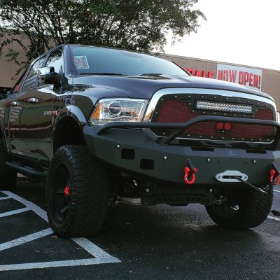

I was thinking in the same direction as you for my build here's what I have come up with so far. Mainly for 4x4'n , fishing and hunting... Zombies tooe2c00b61620c7c707bdcff23d7ff406d.jpgad35279fb07ca3533f6b169727a8e089.jpgb74b67ff1d1ce0ea974df7a802491965.jpga9aec56a4b6858f8e7c8aeb71c9fa9c1.jpg

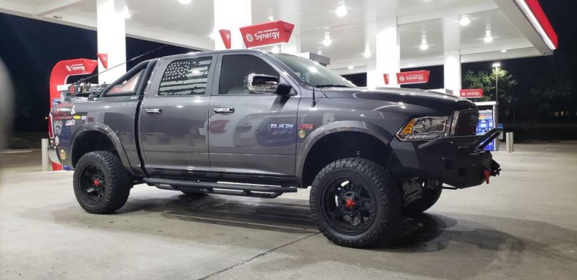

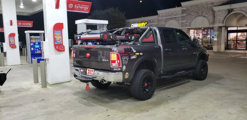

Wow, so much since October
6" rough country lift
33x12 nitto grapplers
20x12 kmc
Royalty core custom grille w/emblem +LED light
Hammered bumper w/ rigid radiance red
Oracle engine LED strip red
Smittybilt 12500lb winch w/ tow hooks
GoRhino 2.0 Chase rack w/ actuator
5 lumen 4" LEDs
4- 3" plashlight cubes in rear rack
40" rear plashlight bar in rear rack
Ram logo brake light
Hi- Lift jack
TygerAuto side steps
50mm 4" antenna
KN air
Borla exhaust
MUD & more MUD
Still2Come:
AEV snorkel air intake
Oracle rock lights
Change diff gearing 4:56
37" tires
Rear bumper with tire carrier
Trip to mohab
