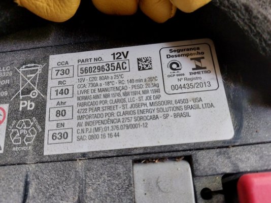

Messing around the other day, checking the difference in resting vs idling voltages between my wife's Jeep battery and mine (hers may be dying). I've only been under my hood a couple times since I got the truck in March. While looking at the top of my battery, I see:
CCA: 730
RC: 140
Ah: 80
EN: 630
I have never seen mention of RC (Reserve Capacity) or Ah (Amp hours) on any cranking battery, only on the deep cycle or dual-purpose batteries for my boat or RV. Just the mention of RC tells me it is a dual-purpose battery, which is an almost-but-not-quite deep cycle. Why is there a wanna-be deep cycle battery in my truck? Usually, in a boat or RV, deep cycle batteries are used so they can be fairly deeply discharged then recharged again hundreds of times without damage. What possible need would there be for that in a truck?
Also, what does the "EN" mean? Never seen that before. And 140 RC equals about 60 Ah, not even close to 80.
