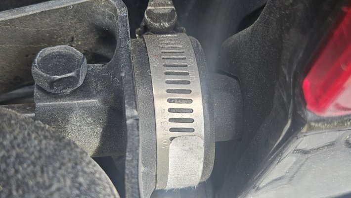

If you ordered one, when you get it check the latches. Even when locked, you were able to open the tailgate using your finger to trip the latch. I always left it locked and used that technique. I also added a hose clamp around the one end of the pivot bushing so that it could not be easily stolen.
