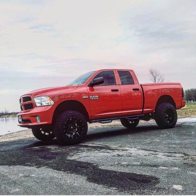

Here's a pic for reference, Zone 6/5 with bils set at 2.8. For my purpose it works because I don't haul very often and if I do it's not too heavy. If I did, I would have went with 2.1. I am thinking about getting a .75" spacer in the rear, but we'll see. As of now I love it.
