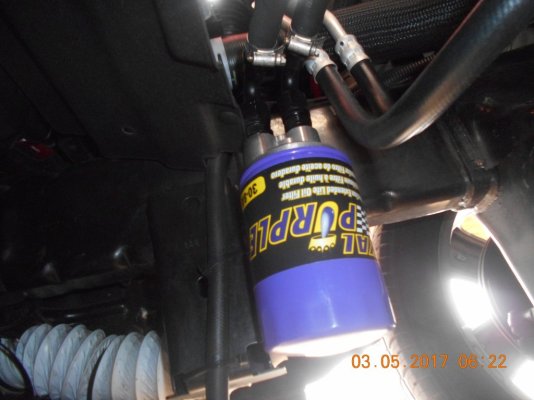

I installed an oil filter relocation kit. It was a bit of a pain to do but should payout on the next oil change. See Post here
Jan 17, 2016
23,853
54,912
14 Sport
Started with a single filter relocation,then upgraded to a dual filter set-up
