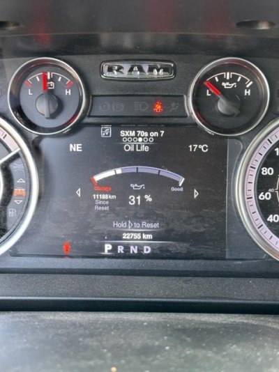

Hello,
I was checking my Oil Life to confirm how far my road trip had been (Toronto to Vancouver and Back). I was looking at the Oil Life while I was refueling the truck. So, I had the ignition in Accessory position. The number since last oil change startled me, 65,535km. This struck me for a couple of reasons;
a) I had reset the Oil Life when I changed the oil the day prior to the road trip. No way was it 65k km!
b) My truck is a 2022 Warlock with 22,755km
Once the fuel fill was complete I check again, this time with the engine in Run position. 11,188km this time. Ok this is the sort of number I was expecting based on the distances I had driven and it's about half the number of total kms on the truck.
So, does anybody have an idea why it would report such a crazy number in the Accessories position? What has me concerned is the 65,535 number is more than double the number of km I have driven my truck. Is this just a glitch? Or is something else going on here? Any thoughts or ideas are appreciated.
I have attached 2 pics of the Oil Life screen.

Just a software bug, the gauge functions probably aren’t even intended to display in ACC. Most likely just showing whatever the max value is attainable for that location in memory. Google buffer overflow.

It's probably getting no data in the acc position, so it defaults to --% and the max mileage since change. That -- in the percent remaining should make it obvious it doesn't have valid data to be displayed in the ACC mode.

65, 535 as a number has significance - it's the max unsigned value that can be represented with 16 bits. Something just isn't initialized yet, so no biggie.
