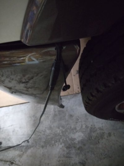

I keep mine on a tender all the time. Hardwired a connection, and ran it thru the fender.
