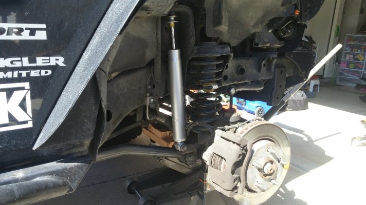

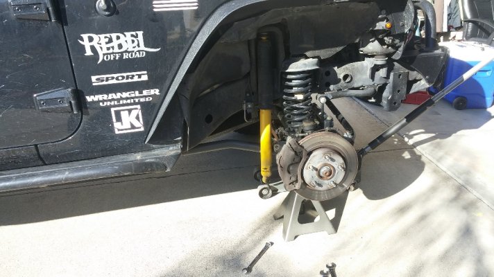

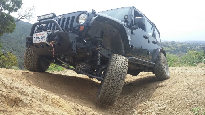

You can customize the OME's in any color you want :)
I wanted to match my Fox 2.0 rear so i just painted them in silver (had OME long in the front)
Before
32541971474_0889e7c12c_k.jpg20170311_080904 by RAM RSM, on Flickr
After
33384941325_a2a61964d9_k.jpg20170311_093830 by RAM RSM, on Flickr
After that the yellow is a thing of the past :)
33811527811_32058e3281_k.jpg20170409_123540 by RAM RSM, on Flickr
