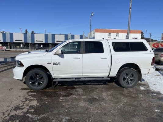

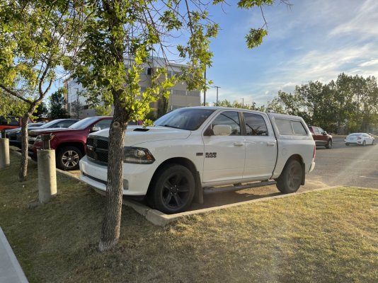

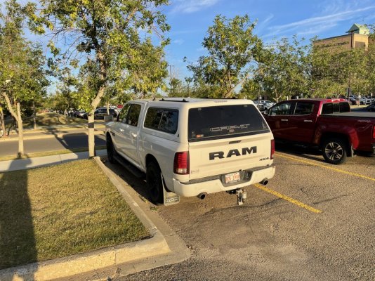

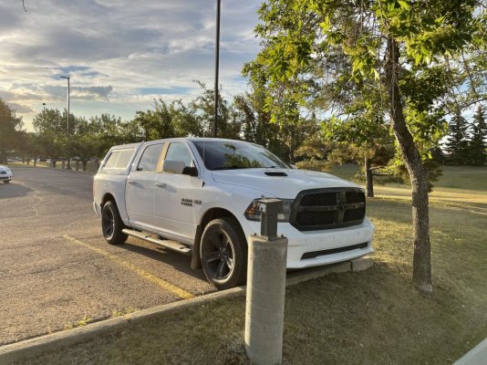

Well, everything finally arrived and I had it installed Thursday. Had 140K km on my truck and the suspension is noticeably better. However, I was told by ARB I’d get a 1.5-2.5 in lift in the rear. It ended up being 4 inches in the front and 6 inch in the rear according to the mechanic who installed it. He measured pre and post install to see. It looks like it too.
Rides good, stock suspension must have been worn out, but more than I wanted. Concerned about wear and tear in other components due to the large change with only coils and springs being replaced.
Only about 50 miles on it so far, definitely needs some bigger tires in the future.

Pre install
