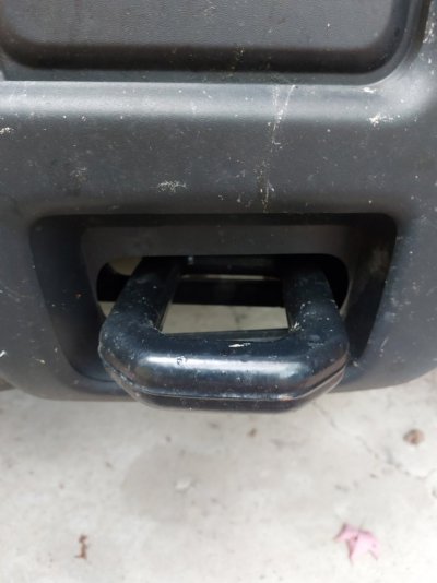

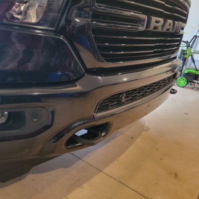

The closed loop pictured above is the updated version.
The open loop style is no longer available from Ram but is available from the aftermarket.
