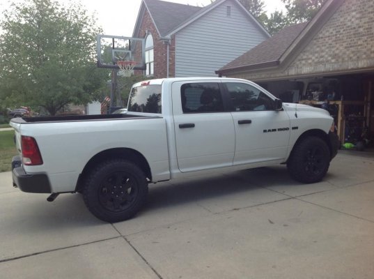

Here is mine with 2" level and 285/70's on 17's if that helps. Picture isn't that great... I don't regret the decision at the time but now I would like more height and tire so in February going with 3" body and 35's
