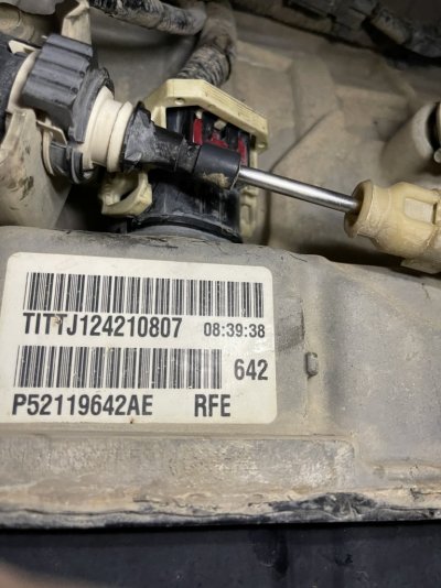

Problem is hopefully fixed if anyone else has the issue! It turns out my 5 volt reference correlation code between my throttle body and my pedal wasnt the problem, the 5 volt refrence to my transmission solenoid was shorting out in my harness plug so i cleaned it and put connect grease on it and it fixed the problem for one day. The lightning bolt came back on the next day so i put my new pcm on the truck and seemed to have fixed the problem so far. My 5 volt reference must have shorted from my transmission solenoid to my pcm frying my pcm. My solenoid might be bad but im going to try this for a couple weeks to see if its a final solution. Hope this helps anyone having the same problem!

Problem turns out to not be fixed…-.-, unplugging solenoid and plugging back in worked for a day but lightning bolt keeps coming back on. Hopefully dropping new solenoid in it tomorrow and resolve the problem
