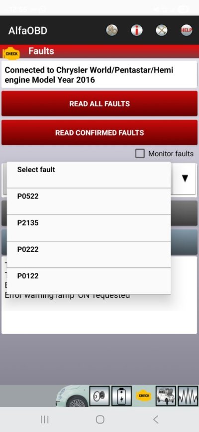

Went to check for 5v (koeo) off the throttle body connector 0v, went to check at the connector before the pcm and 0v as well
Checked all my connectors in C1 and C2 at the pcm no corrosion no bent pins, continuity still checks out but no V

Working on it today I have the following codes now View attachment 583954
Before condemning the PCM, look at a wiring diagram and figure out which sensors share that 5v power feed. All of them.
Then unplug them and retest, one at a time. Unplug, test, plug back in and move to the next.
Any one of the sensors on that same 5v power feed that shorts to ground will pull the entire circuit down, then none of the sensors on the circuit will have a 5v reference signal.
All due to one sensor failing in a short to ground mode.
