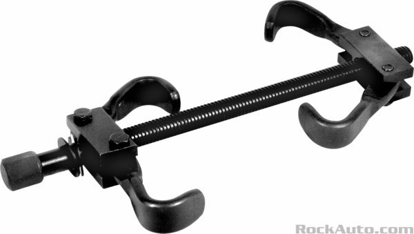

@Snake15eyes1998 I agree with cutting the shaft/nut if the shocks were old, but these have less than 600 miles on them, nearly-new Sachs shocks. They really ride nice and I don't want to drop another $100 to replace a nearly-new part because someone else fudged the part on install. I've checked with PepBoys, O'Reilly, and AutoZone for a spring compressor rental. They offer 2 styles.
This one is most common (what I bought):
And this style:
What I need is this tool, which compresses the spring into the top of the frame/spring perch.
