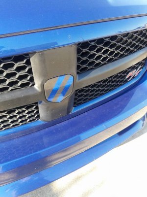

Why paint them just change them completely. i had custom badges made for mine to get rid of the stupid ram head. only like $120 for front, rear, airbag and start button. they can make anything you want. i just sent them pics of quick sketch of what i wanted and they nailed it.
