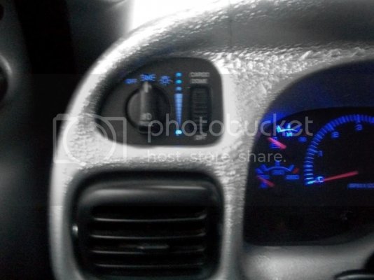

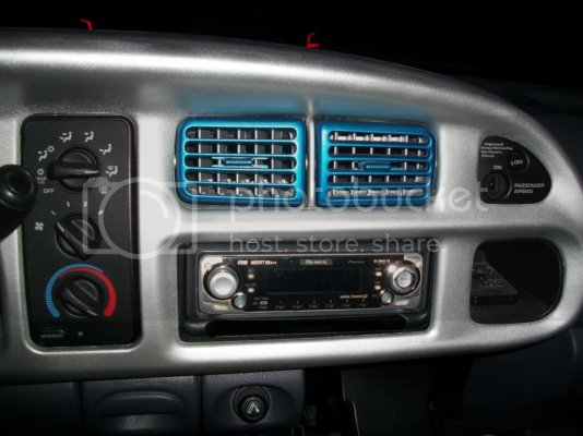

If you use an adhesion promoter it will stick. I have painted lots of plastics and still holding strong. I know JJ (0212353) used some good stuff when he was doing the painting of his retros.
I have dash pieces, door handles, taillights, and my old intake. Now getting the colors to match, well I am still working on that part.
My old dash
Just the vents here

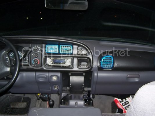

These were for my dads truck
without adhesion promoter
