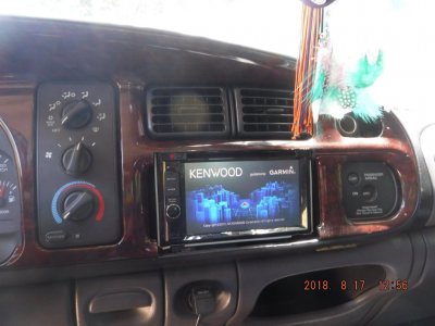

I programmed the new U connect boot screen into it, to look like the 4th gen boot up screen. I also changed the color of the buttons on the unit to blue, because i converted all of my lights to ice blue. i have my HD radio and Bluetooth module on top of the heater box behind my glove box, the 10cd changer under the passenger seat, and the GPS antenna on the back window. I tried to make it look as factory as possible.

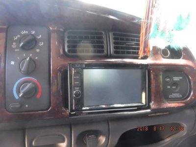

Looks good, sounds good, and looks mostly factory. i will get more/better pics as soon as possible.
