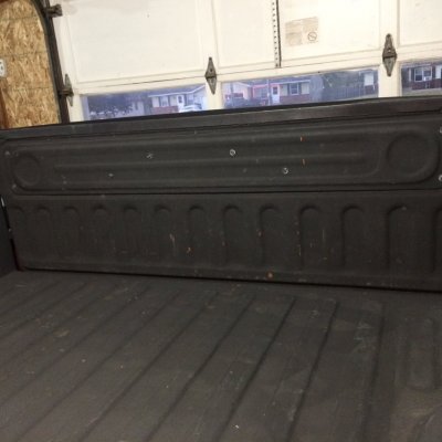

Bummer, I have a spray in liner as well. Thier were about 10ish hex head small bolts to take off the access panel to get "into" the back of the tailgate. IE incase you have to replace the handle locking mechanism. Would you like me to take a picture?

I have removed mine but my tailgate isn't coated. I removed the access panel because I reinstalled it and didn't want to damage it.
If you're replacing it you can just pry it off.
If you can pull the panel you can pinch the back clips from the back to make it a little easier.

I have a spray on liner as well, but don't see any problem removing the panel. Just 8 screws. It appears they removed the screws before applying the liner because they are clean.

Picture would be great I'm not sure where this panel you guys are talking about is. I didn't see any screws.

The 'panel" is where you see the screw heads. Its an access panel to the inside of the tailgate. Hopefully my picture shows up. lol Thier are 8 hex head screws.

That's perfect, I kept trying to get out and look at the tail gate to look for screws but I literally haven't been able to get out in the driveway for 5 mins to check. Hopefully my life slows down this weekend enough to look.:crazy:
