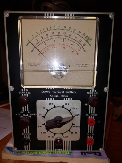

I'll post screenshots to show results.
I could easily believe that for old mechanical measurement gauges.
Our collections are likely similar. :cool:
I have several old analogue VOMs and an ancient DeVRY VTVM that my Grandfather built.
I have a few older mechanical micrometres that leave the new digital crap far behind.
