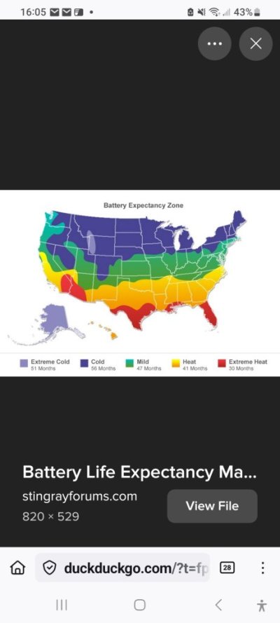

I don’t know about the heat thing .
I’m in south Florida, my 04 made nine years.
While my 14 only made it to eight years.
Both factory mopar batteries.
My 14 got a Napa AGM, as they were the closest,and on sale.

I have got ten and 12 years out of batteries up here, but I take very good care of them and they are in a temp controlled garage. Despite us as outliers, the common experience matches the map. Most Costco U.S. batteries, and everyone else pretty much, have a max 2 or 3 year warranty becuase of the high heat states and not being able to have warranties that are different by region, whereas here in Canada Costco still covers the batteries for full replacemnt to 60 months and prorated out to 96 months, which is 9 years, because their Kirkland batteries last so well in our climate.
