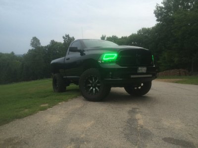

Have a 4 inch rcx now with bils at 2.1 with about a inch of rake but looking to move up to the 6 inch lift and maybe a 3 inch body lift just looking to see what parts I need different. I know the 4 and 6 inch lifts are the same in the rear except for sway bar and the coil spacer so I'm wondering what's different in the front. Just the coil spacer and diff drop? Any help would be great because rough country doesn't like toe-mail me back:flipthebird:image.jpg
