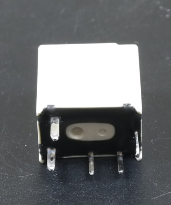

Try these guys (first link). If it's just the relay for the fuel pump, you can buy a new replacement relay from ebay cheap (2nd link below) and solder it onto the TIPM ....cheap. Or, if it's a fuel pump relay, the 2nd option ..and less expensive is to buy a $12 fuel pump relay bypass cable. (search ebay)
TIPM's
Replacement relay:
