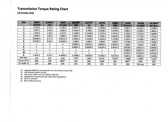

Will your transmission hold up ? I believe a stock hemi at 390 hp is all it can handle.
As I understand the numbers, yes that is the case. Not sure on the of the number on the eight speed. There is a performance section with guys with far more knowledge than I have.
This list might help.
The 6-speed transmissions used for that model year 1500 was the 545RFE which is not on the list. Despite the 8HP 70 and 8HP75 8-speeds reputation for durability, the 66RFE has better torque specs.
