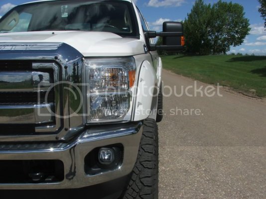

The only time I'll go to them is when they are the same price as Amazon Prime, in my case the Bilstein 5100s. Despite the guy specifically documenting on the invoice "RECOMMEND TO CU THESE WILL NOT FIT" after I read the model number direct from your post to them.
As far as the look, probably something along these lines.... not sticking much further out than the fender, but DEFINITELY not further in than the fender...

I personally feel that a 20x9 with 0mm or a 20x10 with -24 is the best way to go and best chance of fitting a 35x12.50.
That picture looks like a 20x9 with -24mm would, to me.
IMO
20x10 with -24 will stick out(an inch?) further than a 20x9 with -24?

No, it will stick out about an inch further than a 20x9 -12mm
