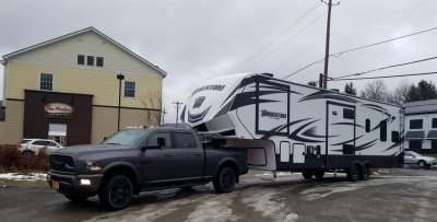

I have a 2018 2500 6.4 and tow a 42’ 5er gvwr 15000. No problems at all. Oh and 3.73’s
Just don’t beat on them. HD Rams are very under rated with their tow ratings imo.

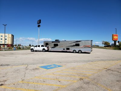

I estimate my toyhauler to be 15K loaded, and my 6.4 does OK on the flats, but not as well on grades. Averaging 7.5-8.5 mpg. Range really sucks. I have not done any super hard pulls, like passes in CO, but anticipate mpg in the sixes. I will be going back to a Cummins as soon as I can swing it. Until then, it'll be screaming 5K up the hills...
