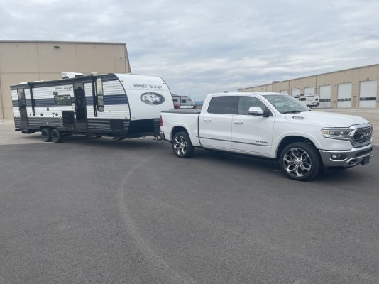

With tow haul on it won’t leave 6th gear. I just towed home this 32’ TT 95 miles today with my 1500. I Set the brake controller, put in tow/haul and took off. it did great, never left 6th gear. IMG_5559.jpeg
