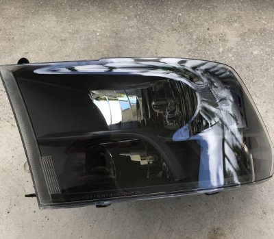

I prefer the quad headlights on the 4th Gens and that’s why I put them on my truck. What most people do is install their new LED headlight bulb and drive. Then they form their own options about them and either love them or hate them. In this thread I am going to compare the AuxBeam to one of our preferred vendors new release Underground Lighting. And go over the proper installation. Both are H11 bulbs in a smoked black housing.

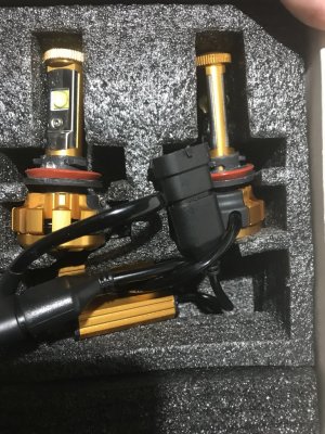

The Underground Lighting Bulbs were very different right out of the box. The cost of these are $199 and the saying you get what you pay for reins true.
Underground lighting is a preferred vender on this forum and the first thing I noticed was the all metal housings. These are 60W 7000 Lumen per Bulb

Here is the underground lighting bulbs

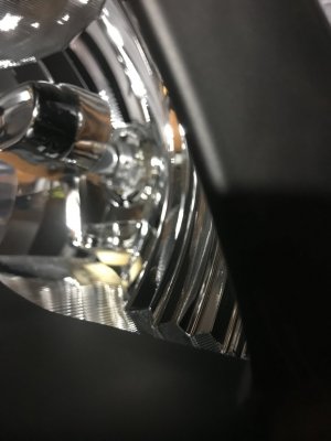

Everything fit inside the housing and the dust cover fits on with no issues. AE7CB47E-CE52-4BC3-BFFC-DFDF26C23CE3.jpeg
As always with anything electrical on your truck use a dab of dielectric grease on your connections. If you look closely at the bulb in the housing notice the led’s are at 3 and 9 o’clock. I did not have to modify the Underground lighting bulbs at all. They clocked perfectly. The Plugs had a Black wire that lines up with the black wire in the headlight harness which made it simple by not having to guess which way the plug faces F4FBE58F-5C57-49A6-BB07-0A6D7A9E08E9.jpeg

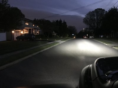

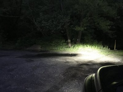

Auxbeam
The big difference here is how the Auxbeam washes out the shrubs and creates a bright spot. The Underground Lighting keeps it natural and in focus. Much easier to drive on back roads. The light is so much cleaner

What I have noticed is that @Underground Lighting creates a cleaner more balanced light output with no flicker or any type of pulse. I wouldn’t call the Auxbeam a flicker more of a pulse.
Notice in the picture pointing down the road you can see the light output is flatter and balanced throughout. With the Auxbeam the hot spot is very clear with light plooming out from the hot spot. With the underground lighting lights the hot spot is much larger and cleaner. Both Auxbeam and Underground lighting are 6K so their is no color difference.
I highly suggest you use the link @Underground Lighting and send Danny a PM or scroll through the preferred vendor list and look them up. These bulbs are top notch and the service Danny provides is phenomenal. Since these bulbs are newly released I will let Danny explain the details and warranty which is longer than most.

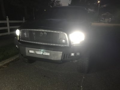

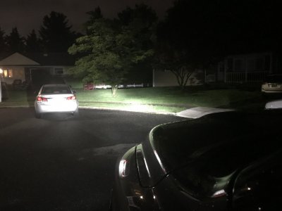

Super clean light output not blinding other drivers. A very nice beam with no strays. Notice my headlights are aimed properly and my light output doesn’t light up the inside of a small car.
