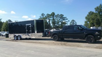

Yeah the dealer said they could find no codes and when manager took it for a test ride he says it shift normally.
Arrhhhh
He did mention headwinds that is where i lost it. Frankly at this point Gremlins is more believable.
When i was towing rpms were 2100 at 62-69 mph didnt matter if tow haul button was on or off but it felt better with it on.
Trailer was a empty 20' V-Nose 3100lbs trailer.
Talked to Customer care they said they will try to look into it.

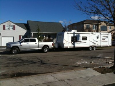

Any updates? My truck was deleted but I ran larger than stock tires and 3.73's and got almost 11 mpg pulling this going a weeeee bit more than 69 mph.
