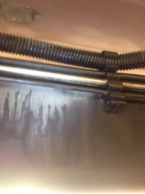

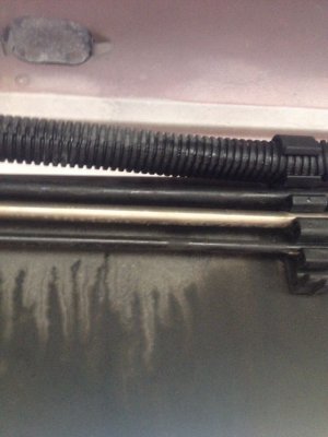

I would say that test was ineffective because I couldn't find anything..ImageUploadedByTapatalk1396245705.923389.jpgImageUploadedByTapatalk1396245724.525052.jpg
This is what I'm dealing with under there. The drippage stain looking things on the back are from the spray, they were not already there. Anyone ever tried a smoke test?

Anyone ever tried a smoke test? My o'reilys recommend I try one of those, what exactly is that?
hemihustlin
Jul 23, 2013
1,718
1,309
Lower Southwest Quebec
A smoke test is more for checking evap leaks, and you will probably have to go to a garage for that. If you really have dripping gas and a ****** pump i would go ahead and order the fuel pump assembly, drop the tank, remove and replace while inspecting for possible leaks. Sometimes the oring where the FP sits can leak, especially when its pretty old (like 2002)
