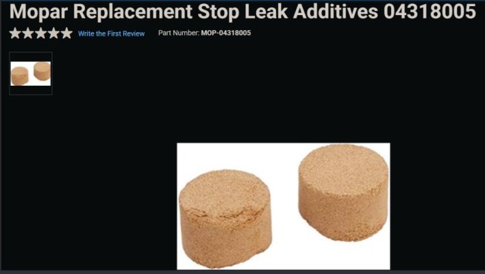

When he got the vehicle back, the dealer told him they installed the repaired engine and added four special stop-leak tablets to the coolant that GM recommended (GM product). He was advised to add the tablets every engine coolant change. The GM stop leak tablets were tan and round (about the diameter of a quarter) and about 3/4” tall - they came four to a pack. The dealer gave him an extra pack of tablets.
Soon after that, my father sold his Cadillac and never purchased another one.
Yeah Caddy's were the worst offenders in my knowledge base and those tablets were ginger root. To fix a small issue of leaky hoses in production they risked engines. Most never knew about it, but others like your example there ya go. GM said they were "natural" and had a OEM part number for it. Sad buy the best of the best and a 10 cent tablet can ruin it. My pops was a caddy guy as well, although he never bought anything else. Couldn't afford food, but he was always in a caddy.
I had that engine in a 1984 Seville. It was an aluminum block with cast iron heads. There was a TSB on the intake gasket. I had that done by Kmart of all places. Those pellets were crushed walnut shells if I remember correctly. I even used those pellets in a 5.4L Ford with a leaking gasket. I was leaving a trail of white smoke behind the truck. Put the pellets in and I watched the smoke dwindle to nothing. Lasted a year or so before I had to give it another dose. Gave that truck to my metal scrappers and told him about the problem and what I did, and he’s still running the truck by adding more pellets periodically. He works the truck pretty hard and runs it up and down the east coast from Pennsylvania to Florida.

I've used 'Stop Leak' many times over the years. Never once had a problem, and it always seemed to work, at least for a while. I will say that I ALWAYS used it sparingly and carefully, haha.
