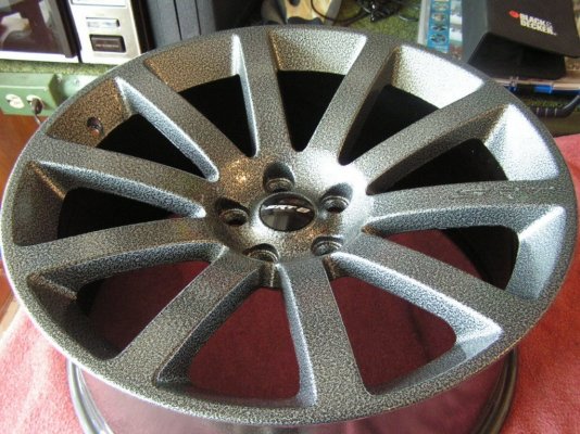

As with paint, it's not a hardness issue so much as a thickness issue. It will scratch but the key is to get a good topcoat of clear which will be easy to buff.
I powdercoated the wheels on my car 8 years ago and they still look awesome. They took a few dings but were easily cleaned up as I have a 3mm thick layer of clear over the entire wheel.
