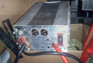

My dads is like this one need to find a place it will actually fit

Yeah I am gonna check for under the front seats somewhere. He has a smaller one I am hoping to snag from him too.

What a beast.
