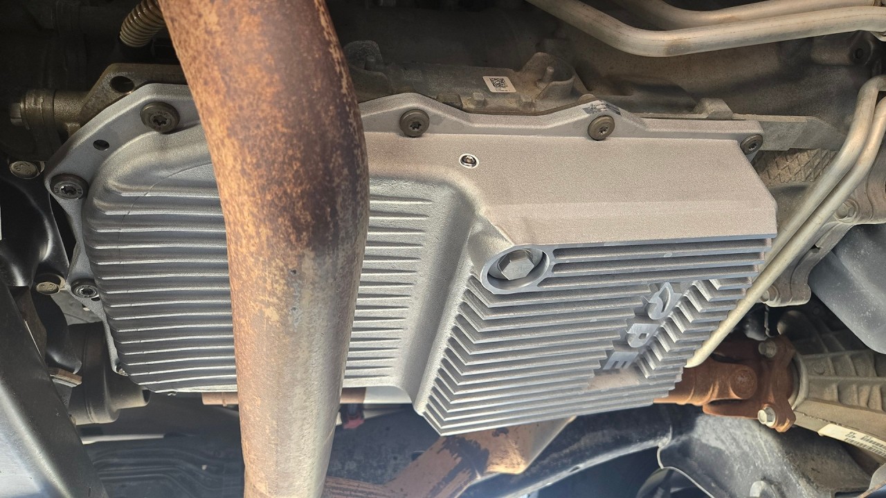

Like you, I also have the bypass kit, it's sitting on my workbench. My truck is just hitting 70k miles, so tranny service is due anytime.
I like the thought of the extra fluid in the pan. I plan on using this method of refilling the trans, where they keep the truck level, with all wheels off the ground. In that linked vid, they also loosen the tranny mounts.
I'll be using my 4-post lift, and will be raising the rear at least enough to get the rear wheels off the ramp, so I'll be ~halfway up to the 'green sheet' specified height.
RAM 1500 PPE Transmission Pan Install
Servicing the transmission in my 2017 Ram 1500 Rebel and replacing the stock pan with an aftermarket aluminum pan from PPE."Green sheet" instructions - https...
