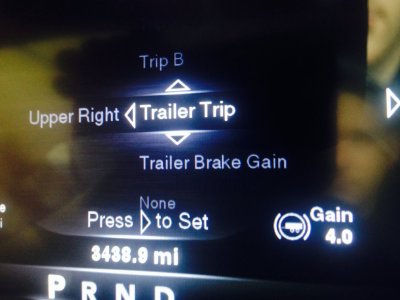

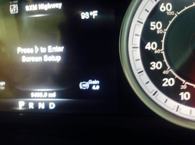

So I got it in stalled. I could not get the third screw in...what a PITA!!! I spent an hour but my hand just could not maneuver around to put it in. So after I got it installed, I went to the EVIC and I have the Trailer Gain and Trailer Trip but do not have the option to change the brake type or any other setting. Is this normal until the trailer is connected? Attached are some pictures.

bobbo7915

i have the smaller EVIC in my truck, not sure if it is different on the fancier version...
Andy578
i have the uconnect 5 so it could be different but i have the trailer brake type option at all times

I took it into the dealer and they said they needed to flash it to activate the rest of the funcitons.

Had it flashed today and there must have been a Update to the 5.0 because they did not charge me and it mention PCM Update "Warranty" on the bill. Everything is working and I have full selection of my trailers.
