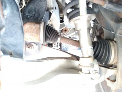

This is a Procomp 6" setup. I have not had any issues, 50k miles on lift. I feel it is time to replace tie rods and CV axles though.

I thought the stage 2 just added the front struts/coilover
Sure as ****, those are not Procomp uca's and the stage II kit does not include them. Thanks for pointing that out JB!
