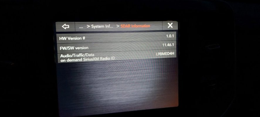

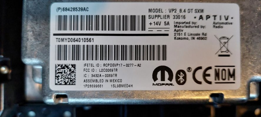

Hello everyone,
I'm experiencing an issue with my VP2_8.4 DT SXM 68428539AC radio (without navigation) in my RAM 1500 5.7 2020 BH. The radio restarts every 3-4 minutes, which also affects the rearview camera functionality during reversing. The dealer mode display differs from what I've seen in online photos (see attached photos). Additionally, it's currently impossible to pair any phones via Bluetooth, and the SXM service is unsubscribed.

4. yes, the VIN is not needed, the number on the sticker on the back of the radio is enough

Update:
1.^^
2. according to this page: www the replacement numbers are 68428539AA, 68428539AB, 68428539AC, 68428539AD, 68428539AE, but according to this page: www 68428539AA; 68428539AB; 68292209AG; 68292209AH; 68292209AB; 68292209AD; 68292209AE; 68292209AA; 68292209AC; 68292209AF; 68428539AD
3.you can upgrade the system to a large screen version, but you will need additional cabling, or choose something from the supersession list, where the further the letter of the alphabet, the newer the device
4.^^
5.if the screen change occurs within the replacement list of the same number, then it will match, I have not checked other numbers
Finally I bought a new radio 68428539AB + screen replacement + purchase of anti-theft code + coding of additional functions + change of localization to Europe and language to Polish
Thanks for your help, the topic can be closed.
