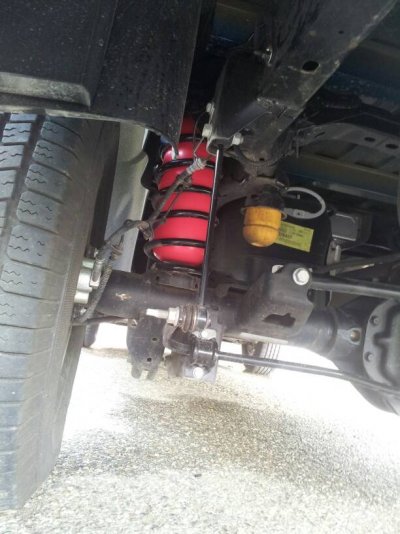

All went good took 1 hour time
I found 2 holes under tailgate area I mounted the valves to otherwise easy install

Looks good. What do psi you have them set at?

Looks good the tailgate doesn't hit the valves when you open it????

Tail gate doesnt hit valves I checked several times before I bolted them in
I have them at 15 psi right now took for a good boot doesnt squat as much when you give her some go juice
Im extremely happy with them so far

Aren't the valves a bit awkward to get the caps off? Looks kinda tight is all...
Airlift is some of the best $ you can put in a RAM if you have to tow.
Works good for me ive been checkin the air pressure all night no issues with caps

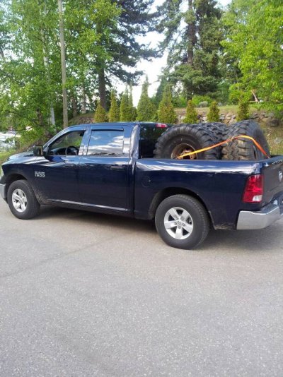

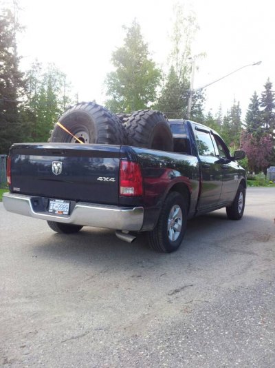

Well hauled some tires with the ram she did good each tire was filled with rubber and half inch steel plate rims definitely noticed it but she hauled them no problem

hope you check back here, I have a question for you. Did you have a hard time getting the hose onto the bag once it was in the spring? or did I do mine wrong. I installed bag, then black doughnut, then hose. Mounted my stems like you did as well but putting the hose onto bag was a pain in the rear. I just couldn't get the clamp seated to my likening. I'm gonna get some angled needle nose and try tomorrow...

I used a little spit over the metal piece and the hose went on easy, then did the same thing on the hose and wiggled the clamp over. Push on opposite side when clamp is pinced then push down on clamp side and repeat lubricate as needed. Worked like a charm for me.

What I did is jack truck up via frame rail next slide bag in coil next run airline through next black puck next ran line through blk spacer than lifted spacer up put clamp on hose further up than dunk hose end in hot water it expands a bit for a second or 2 slide on than bam onto next side

On my install, I just stuffed the bag in between the coils. You don't have to remove the coils. Airlift FTW.

I just held the ring doughnut/ring up on top of my handwhile pushing the hose onto the barb. Once I slipped the clamp down I let the doughnut/ring drop and voila.

Yes jack frame up extend coil.....nonneed to remove coils and lift doughnut up and do airline
