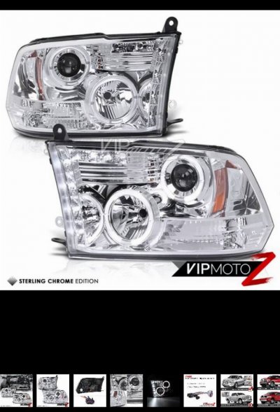

I had those one from vip moto. Good customer service but not good quality in my opinion
One halo would not fire intermi tsntlly. Fit was kind of shotty. Had to elongate a mounting tab to make bodyline line up. I am pretty picky though.
In my opinion there was just to much that could go wrong with them with all the halos and stuff. Did not see them lasting.
Also. Aim was way off. Could of adjusted but by that point i just ended up returning.
Not to mention the gobs of wires u hace to tie in on the back.
