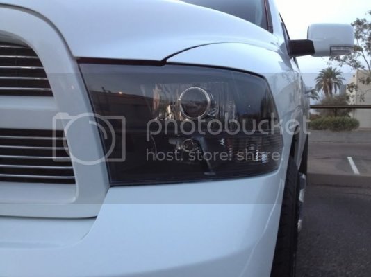

I'm planning to black out my '13 Express and have been looking at black housing headlights. I found a few projectors for around 300 that I like, but there are some for $15 more that look like there's a lot of extras in the housing. What should I be looking for when searching for headlights? What kind of bulbs should I get with them? Do I need to purchase bulbs desperate because they don't come as a full package with everything? Also, is 300 too much for what I'm wanting? Any help is appreciated.
argray90
Mar 30, 2013
2,261
316
NW Burbs, IL
4.7
What brands are you looking at? That is the variable for pricing. There are so many different types makes and all it is hard to say. Check out retroshop a vendor here he has many different options for projectors as well as HIDS. Projector headlights require H1 bulbs so if you get HIDS for your projectors make sure to order the correct bulb. Projector headlights can run anywhere from $250-$1,500 so there is a wide range of things to see.

What about the Angel Eye Halos
emjohn4
Jul 25, 2012
1,220
868
Odds are, they are junk - but I don't have any personal experience with those particular lights.
If you like the style, get the lights, and put in quality HID projectors in them in place of the existing ones.
Good projectors will have a beam pattern and cut-off like this (my retrofit in my Durango):
Have you considered painting the OEM housings black? They retrofit very nice, giving you a good output, and the paint really changes the look.

Vols I have the projectors you are looking at. They are actually great headlights. Made by spec-d. PM me and I'll show you actual Picts of them on my truck running.
emjohn4
Jul 25, 2012
1,220
868
Post them here! :hmm:

I have more just too lazy to do them off my phone. For the price they are great. Way better quality then OEM. I might send out my extra set of stock headlights though to a company who retrofits them for $350. Have yet to find a price even close to that plus all work is money back guaranteed.
argray90
Mar 30, 2013
2,261
316
NW Burbs, IL
4.7
I don't have any of he cutoff yet living in the city makes it though to find a dark place ill get some soon.
emjohn4
Jul 25, 2012
1,220
868
Funny that! :joke:
Without output pics, it's pretty much impossible to judge the performance of a set of headlights.
I'd wager to say that the beam pattern is far from adequate, even if it is better than stock; and that the cutoff isn't very crisp/clean.
argray90
Mar 30, 2013
2,261
316
NW Burbs, IL
4.7
Funny that! :joke:
Ok we'll I've driven with them at night and am way happier with them over stock. Ill make sure to try to get a cut off pict soon. If its better then stock isn't that an upgrade?!
emjohn4
Jul 25, 2012
1,220
868
Yup, still an upgrade. Just not to it's fullest potential. :headbang:
But, if you like the style, that's what matters.
