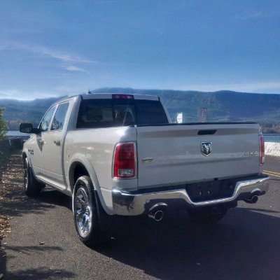

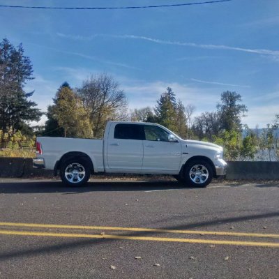

Finally got a few pics. I work remotely 9 weeks on/9 weeks off so I did all the footwork and my wife picked it up. Unfortunately, she now want's to trade me her Acura MDX for the truck. When I get home, I might have to arm wrestle her for it....
I gotta get a level kit on that baby ASAP so I can get rid of that stinkbug look.
