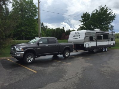

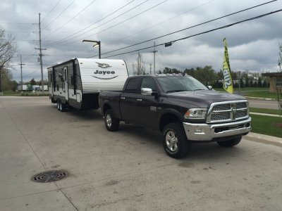

How do you end up with basically no sag? You have bags?
Sent from my SM-G950W using Tapatalk
Yes I have airlift bags and daystar cradles.
But, before I leveled the truck I didnt need bags at all for our travel trailer. The weight distribution hitch kept it level very nicely. I will see if I can drum up a pic from back in the day.

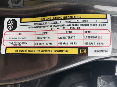

Spot on. My 2018 PW is rated for 10,347.51 lbs tow and 1387.5 lbs payload. It’s the same power train as the regular 2500.

You are correct in pretty much everything except the tow rating - from what I've gathered, most Power Wagons are rated at 9k or less.
Yea, my loaded ‘16 laramie (ramboxes too) has a payload rating of 1135 pounds...less than my half ton ram.
Also, the towing rating is only 8510 pounds.
