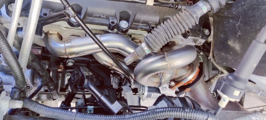

I took these pics after it was running for 15 min. Headers turning bluish, that's normal.
The only real issue I had was the dipstick tube. It didn't fit without it pressing hard against the headers. So I had to bend it and had to zip tie it out of the way. Kooks sent a spacer for the tube to come out about 3/4" but there was no way I could get it to clear the headers with it. Anyway it's ok for now. I'll try to figure something out for that. bab8248a03b92ca4c8bd392964114885.jpg

Well after letting cool it down for several hours, I turned it on again. I heard a noise again but it's not a ticking sound, I think it's just the normal engine sounds that I probably don't normally hear cuz the wheel wells are on and the hoods closed. Anyway, It's too hot outside in Houston today, and I have the day off tomorrow so I'll retorque the bolts in the morning, and put it all back together. I'll take it on the freeway tomorrow and see how it feels.
El_Dude
El_Dude
Nov 11, 2020
222
216
Spring, TX
2019 Classic SLT
Found 4 manifold bolts kinda loose and all ypipe bolts were kinda loose too. Got it all tightened up again tested for leaks with the vacuum method. Took it on the freeway and all seems good. Job done.
