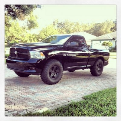

Well, here it is....36's which measure closer to 37" with nothing but a 2.5" level. No rubbing at all except full clock to the left. The rubbing is very minor on the driverside plastic and I will be able to fix it with some zipties. I ended up needing 1" spacers so they wouldn't rub the knuckle.

Wow that's badass. Does it ride any different now?
