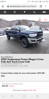

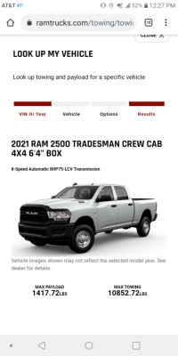

Looking at the payloads for various 2021 PW’s on the ram site, I’m noticing some inconsistencies in some of these built trucks and how they’re optioned. In a few instances some significantly more optioned trucks are turning up higher payloads than the barer bones trucks. Is there something else at play here or is the website known to have errors for this? I’m looking them up by VIN.

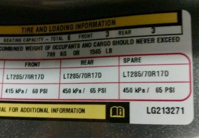

GVWR 8565 minus 1565 payload means the base weight should be 7000lbs. So you are 50 pounds off...did you change wheels also? Could be your tire and wheel package saved you some weight, @retired
For reference, my Tradesman Crew 8' bed with only protection group and tow mirrors as the only option weighs 7002lbs.
And the chart lists a Tradesman with Powerwagon Package having a max payload of 1620. Of course you can option the tradesman up to weigh more than a base Powerwagon trim.
But 1620 would be the most and I have seen door stickers as low as 1065.

this was the tradesman with pw package I looked at before buying my pw.DD58FF67-F67C-473C-8652-28AD511A2068_1_201_a.jpeg

That tradesman grill is so clean next to that ugly plastic kidney bean on the PW. Why Ram decided that customers have to choose between having chrome bumpers or an ugly plastic grill to have a PW is beyond me.
I agree the PW grill is the worst of all the grills (and the rebel) even with the chrome bumper it looks 100X better than the PW front end. Only reason I went with the power wagon was when we were test driving them I asked my wife which one and she liked the PW interior much better and the rest is history lol.
