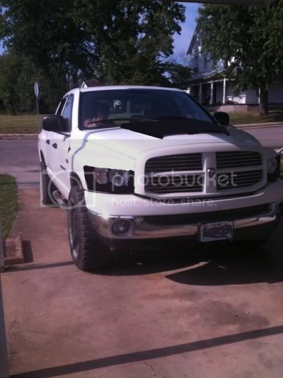

Pretty sure that's why even when they just do a hood, they blend the paint into the fenders at the same time justso you don't get that off color while looking at it. Now for the blueish tint, it could be due to the primer used. Some primers bleed through and can change the look of a finished project if there were not enough coats of color on it. For example take a reg blue paint, spray it over a white primer grey primer and black primer, if there is not enough coats the black primer turns the paint a deeper blue while the white turns it a brighter blue. So it could be he used a grey primer and didn't do a thick enough coat and the grey is bleeding through the white. Do you have a couple pics to see how bad its off?
its really weird.. sometimes its not noticeably bad, and other times it makes me cringe. some people dont notice and other people tell me first off "omfg who did u have paint your hood???" i'll takes some pics here in a couple minutes for ya

Wow, that is really different! I'd be on the phone with your painter to get him to redo it, its not even close.

I mean spots of it look right but the bulk of it looks way off
there lies the problem... this was painted 2 years ago when i installed it on my 02.. it didnt match then but it was not as noticeable on that truck and the bug shield on the 02 helped it not be as noticeable as well. now i have no bug shield and i cant really afford to have it painted again. i had a guy i know offer to do it for the cost of paint and blend it into the fenders but he is a sketchy guy on and off drugs real bad so i really dont trust him. hell maybe ill just paint the whole hood black! :shakehead::joke:
